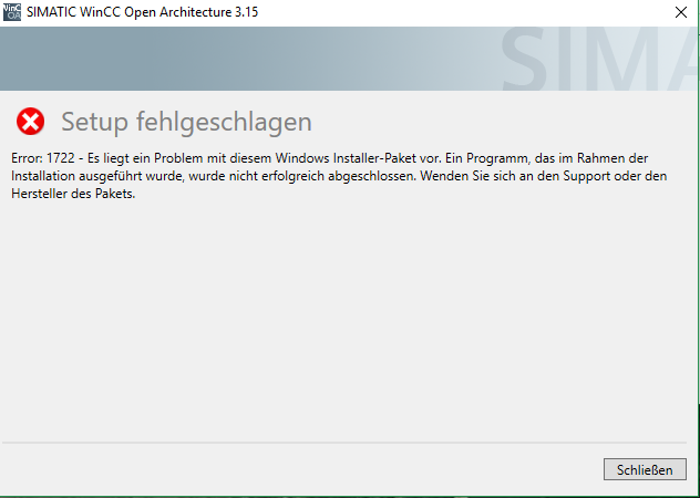

i tried to install the Patch 5 on Windows and get an Error 1722.
Please see attachment.

Most likely, the downloaded file is corrupt.
Please verify the MD5sum, you can find it in the portal alongside the download link. As an alternative you can verfiy the digital signature on the downloaded setup file.
If the file is OK, in some cases a restart of the machine helps.

Thanks for the help.
A restart of the machine was the solution.
