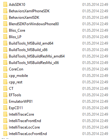

Update 2: http://go.microsoft.com/fwlink/?LinkId=393220
Update 3: http://go.microsoft.com/fwlink/?LinkId=403041
Both ISO contains 64bit too:
