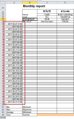

In monthly report, when I set the time at 00:00, the time data indicate as below.
But I change the time except 00:00 in monthly report, the time data is correct position. And also the time data at 00:00 is correction position in daily report.
How can I fit the time data position in this report?
WinCCOA Version is 3.15. Is this bug in 3.15 version?

The format for the cells needs to be defined at the template.
Therefore please open the template, select the cells in column A between "Data" and "Footer" and set the desired format.
