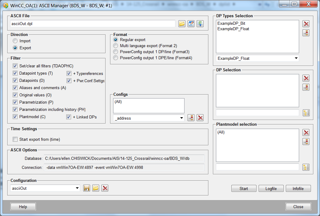

Hi Leopold,
I selected 2 DP types, chose Set/clear all filters and entered in the new ascii file and configuration name. Pressing the save button produces the error.
Testing it again now, I found that selecting all the filters individually (instead of choosing the Set/clear all button) does not produce the error!
Ellen https://www.winccoa.com/fileadmin/image ... /ascii.png
Re: Ascii Manager Errors
Thanks for the information, now I could reproduce the error. The problem is that the entries in the dp list are not correct when activating/deactivating the option to set all filters.
I've fixed the problem. The bugfix will be part of the next patch for WinCC OA 3.15.
