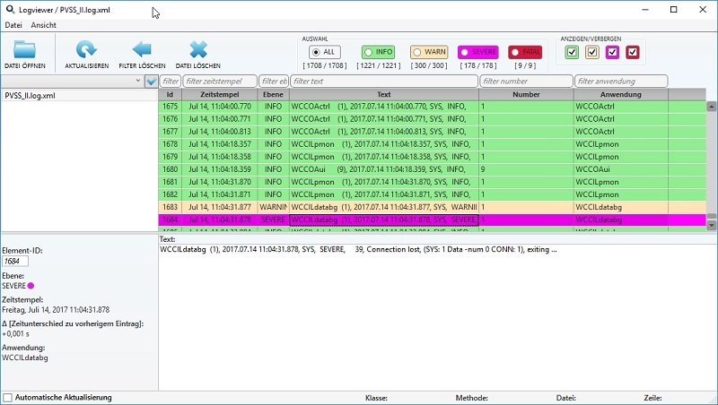

cool, you have a good tool to view/analyse logs?
right now im using regex (PVSS|WCC).*(19[0-9]{2}|2[0-9]{3}).(0[1-9]|1[012]).([123]0|[012][1-9]|31) ([01][0-9]|2[0-3]):([0-5][0-9]):([0-5][0-9]).([0-9]{3}),.*(INFO|WARNING|SEVERE|FATAL).*,

Maybe for a new Projekt. But right now im looking for ways to creating a Tool to analyse old log files like PVSS_II.log
