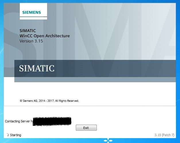

Hi, it`s me again. :)
Is there now in Patch 007 an option to allow the modification of the first splash screen of the desktop ui?
We are still looking to allow a continues branding.
Please find below a the splash screen I´m talking about:
Re: Desktop UI Splash Screen branding
No
