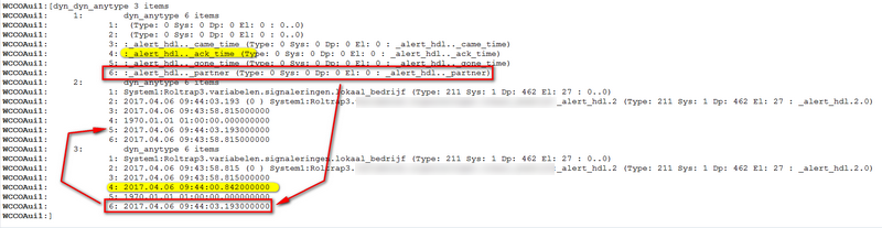

Does anyone know if there a way to construct a dpQueryConnectSingle() to return the _ack_time for "went" alerts? In the code below the ack time is populated if the sequence is came->ack or came->went->ack but is null at the went stage if the sequence is came->ack->went.

Hi Jim,
Sounds logic, since the went event was not acknowledged, but the came event. Luckily for you, these two are 'partners'.
Take a look at the partner of the alert. In your query, also connect to the '_alert_hdl.._partner' attribute, you'll notice the following:
Instead of only 2 items (header and went alert), you will receive a third item: the partner of the alert that went, which in your case is the CAME ACKED alert. Since this is the one you acked (and not the went alert), this one will have the acked time.

Hi Joost,
Great tip, I new about the _partner attribute but had not appreciated that it would be populated in the came alert too and hence fire the callback.
