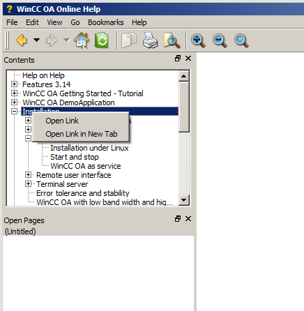

Ah, ic. The thing with the right-click works for the help file of WinCC OA 3.13 where it was a CHM-file.
Now it's a QT Help Collection (*.qhc). The assistant.exe is the viewer. But it doesn't seem to have this feature. A quick google didn't help either.

The problem is, the Online Help Tool doesn't let me print out the whole manual. I am only able to print page by page. There is no option "Include Sub-Chapters" or similar.
