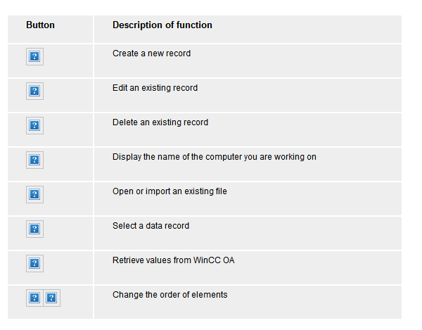

with the new patch P008 most of the images in the help are disappeared.
Some one knows something about?
We have the same problem in 5 laptop.

I had a look at a system where P008 for WinCC OA 3.14 is installed.
In the documentation I can't find any page where the images are not displayed.
Can you please give us an example (path in the chapter tree) where the images are missing.
Are you using the german or the english documentation?

Re: [P008] Help Images
Thanks for the chapter, I could verify it.
I have immediatly forwarded it to our documentation department (internal ref #17029).
I expect that the next path for 3.14 will have this issue solved.
In a fast check I did not come across additional missing pictures. If you have found additional ones, please do not hesitate to write them here.
Also, if you need the help for this chapter right now, you can check the documentation of 3.15, its correct in there. I have also added it here as PDF. Hope that helps. https://www.winccoa.com/fileadmin/image ... e_3_15.pdf
Thanks for the help.
In general everywhere the images are missing.
The problem with the missing pictures was solved. During the automatic build of our documentation all file extensions in the links to pictures were changed to lowercase, even when the pictures in the link have an uppercase ending.
Thank you for notifying us about that.
The next patch will include the change.
