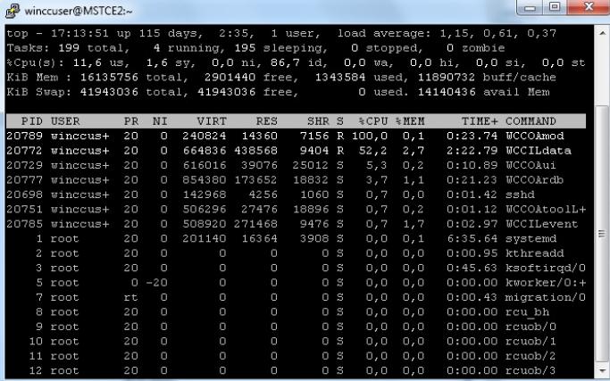

You are right, the cpu of the WCCOAmod process is kept 100% for a long time until it has just started, this may be the problem.
