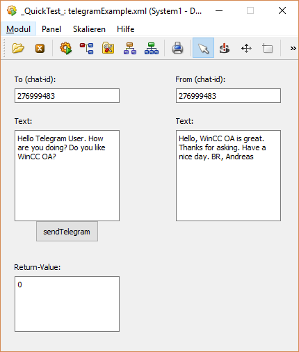

Usage:
See the example panel. Like in this example, send and receive messages can be done client side. Only the server does the connection to the telegram servers.

I did a small update for the telegram messaging service, see above.
Whats changed:
  • DPT changed, added some elements necessary to send return values to a client
  • renamed the DP to _telegramMessage to make it specific to this service
  • added a lib with predefined send an receive functions for Telegram, this can be extended for other REST services
  • the sending function will now return the result of the server (even on client side), dpSetAndWaitForValue() is really a great function
  • there is now an example panel
Hope you enjoy it. Feedback appreciated.
