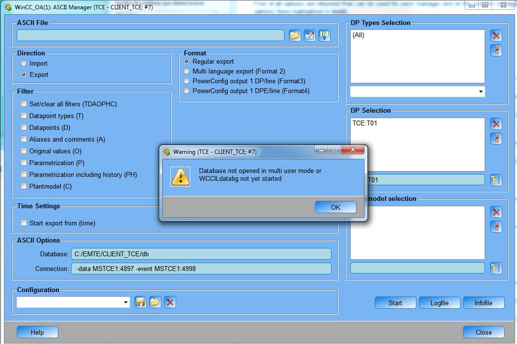

Hi! i try to export/import from/to server from a client with a ParaRemote license.
I can open GEDI and ASCIIManager, select the dp i want export, but when i click start the error appears:
Database not openend in multi user mode or WCCILdatabg not yet started.
In the ASCII options i can see the incorrect Database ( its puts the local path...not the server path), the Connection Option is correct: -data SERVER_NAME:4897 -event SERVER_NAME:4998
I try to change the Database for the correct path but the error appears again....it's seem the ascii manager attemps to connect allways to a local database.....and don't exists.
How can i export/import correctly?
Thanks, https://www.winccoa.com/fileadmin/image ... s/snap.jpg

ASCII export reads the database files directly, hence you can not do this from a remote client

hummm....i can't understand....and now how can i export/import from client??
I can change DB, i can change panels...but i can't import o export dp's??

The answer was not clear enough, the ASCII needs direct file access only for export. Import from remote is possible and should work.
