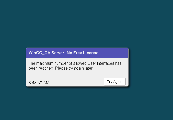

We just started up a little WinCC OA solution using the Ultralight Client as our only interface (1 ultralight client license).
First morning after startup the customer calls and cannot connect to the system because of "No free license" :dry: See picture. I tried to close the Chrome browser and open it again, with same result. Then I restarted Control Manager "UltralightClientServer.ctl" and it was now possible to open the UI.
I then tried to replicate the problem by opening browser and logging into the system and then closing the browser again. After repeating this 2-3 times of i got stuck in the same situation as my customer. I then restarted the UltralightClientServer again and started repeating the same steps again 8-9 times without any problems.
Is this a problem any of you have seen before? And is there a way to fix it? Besides buying more ultralight client licenses :P
