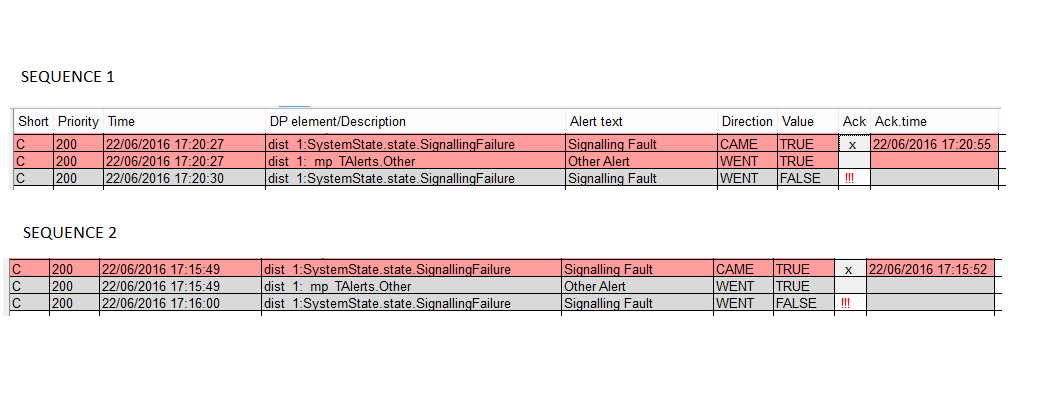

I've checked the alarm screen and the sum alert colour is different depending on when you acknowledge the CAME alarm.
Sequence 1:
Single alert is WENT / unacknowledged
Sum alert colour is CAME / acknowledged
Sequence 2:
Sum alert colour is WENT / unacknowledged
I've attached a screenshot of the alarm screen in both cases.

Re: Sum alert
the difference is maybe caused by the order of messages received for the alerts.
The summary alert gets as last information the acknowledgement of the CAME alert in sequence 1 and therefore this color is displayed.
