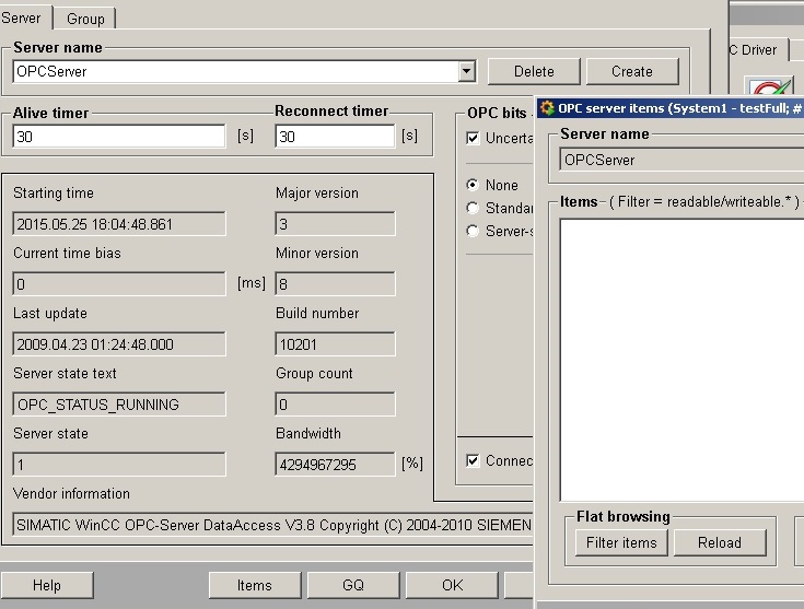

Is it possible to use a OPC DA client manager on the remote driver?
Is it possible to use a OPC client on the remote driver?

can you please describe in detail what you want to do.
It is possible to start the WinCC OPC DA client on an own machine with connection to the WinCC OA server.

Re: Is it possible to use a OPC client on the remote driver?
do you see any errors at the logviewer when trying to browse the items?
Have you tried the buttons to filter and reload the items?
After clicking on the Reload button, a warning message is issued: no heartbeat for 30 seconds.
It's working with WinCC 6.2. That's enough for me)) Thanks.
