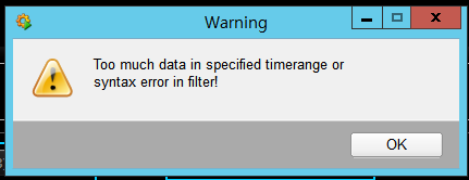

Today, I had inserted DPpoint (1,000 ea) into WINCCOA.
and then, started a vision (Runtime).
suddenly, Warning popup was displayed.
"Too much data in specified timerange or syntax error in filter" - refer to attached file.

and Let me know how many DPpoint WINCCOA could get ? Image
Re: Error : Too much data in timerange or syntax error in filter
can you please have a look at the PVSS_II.log-file for the server and the client (if a remote UI is used).
If this error dialog is shown you should find there additional information. If a log-message is written when this dialog is opened please have a look at FAQ --> Log-Messages. In this section a lot of log messages are explained.
