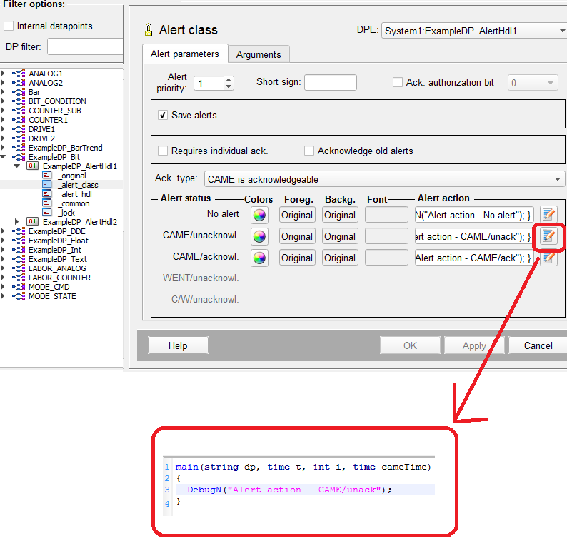

I still cannot got this to work. Will include a screenshot to make things more visible.
As you can see I have included an action in all three states. This action shuld print to the log viewer using "DebugN". But no text appears when I trigger the alarm by setting the value to "TRUE".

Are you sure you are using exactly THIS alert class in your alert_hdl config ?
I'm pretty sure it's not.
Try changing the alert_class config on the corresponding _AlertClass DP

Now I put the alert action in alert (DP of type _AlertClass) and it works. The alert action is executed when I change ExampleDP_AlertHdl1.
I have two questions still.
1. Where is the connection between alert and ExampleDP_AlertHdl1? What tells the system that changes in ExampleDP_AlertHdl1 to be handled with the actions described in alert.
2. How can different DPs be handled with different actions? Why is not the actions defined in a specific DPs _alert_class executed?

ad 1)In the alert_hdl config you define which alert_class to use. The ones which are shown in the combobox are all _alert_class configs put on the internal DPs of DP-Type _AlertClass. If you want to use any other alert_class config, you need to specify the DPE on which this config is on, in your case it would be the ExampleDP_AlertHdl1 DPE itself (use the button to the right of the combobox in the alert_hdl Para panel).
ad 2) the actions are specified on the alert_class. You can either create a script, which checks from which alert_hdl DPE it was called and do different things, or you need to use different alert_class configs which then have different scripts attached.
