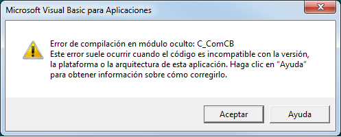

We are trying to develop reports for our SCADA system, but when we start the Excel Report, this gives this error message that appears in the attach image. We would like to know how we can fix it
thank you very much. Image

I can't read the text as it is not in english or german language.
Can you please try to switch the language of your operating system to english. Afterwards please start the Excel report again and check if the error occurs.
Also the information which WinCC OA version and operating system you are using is needed.

Achieve solve the above problem but now I have another drawback throws me the following error "Error 30519" I wonder if I can make the templates within the reports to the error or if there is any drawback to create templates having this error.
I appreciate your help Image

We are facing the exact issue as you have mentioned. Error in the compilation module when the report.xls file is opened.
Could you please tell me how the issue was resolved?
Re: Excel Report
there are several modules loaded when starting the Excel report.
Can you please post detailed information which error is displayed.
