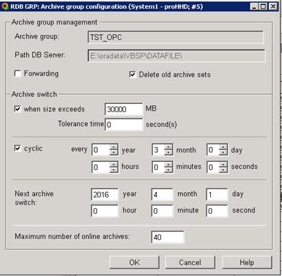

I was wondering how to change the path DB server for an archive group.

Found it in the oracle db under ARC_GROUP

I'm not an Oracle specialist.
As far as I know the path for the Oracle database is defined when configuring the Oracle connection. As the path is predefined then it cannot be modified at the WinCC OA panel.
I'm not sure if it will work when you change the settings in the ARC_GROUP table in the Oracle database.
