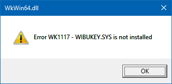

I have just installed 3.14 but when I run the console I get an error message saying WIBUKEY.SYS is not available.
Re: WIBUKEY.SYS
have you installed the Wibu-Key-package during the WinCC OA installation?
Are there other WinCC OA versions installed at the same computer?
mhargreaves
Posts:84
Joined: Thu Nov 11, 2010 12:31 pm
Re: WIBUKEY.SYS
Post by mhargreaves »
I had installed the Wibu-Key package.
I had V3.13 also installed.
I've now uninstalled everything, including V3.13, and reinstalled and now everything seems fine.
Thank you
