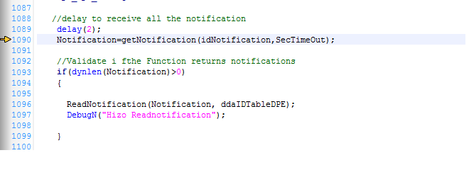

Hello Martin, thanks for your help, the manager blocks when I call the function of the Ctrl Manager, this function is GetNotifications and allows to recieve notifications from the web service, I create this function in the Ctrl Extension using GSOAP, this function has 2 parameters, ID of subscriber and the time which the function is open to receive the notification, I determine the time by 1 second. When i interrupt this part of the Mangaer, i Cant receive notifications, on the other hand, the manager doesn´t block, I attach the part of the code Image

To continue the managers main loop you could use implement 'WaitCond' class, which executes the time costly function in a separate thread.
