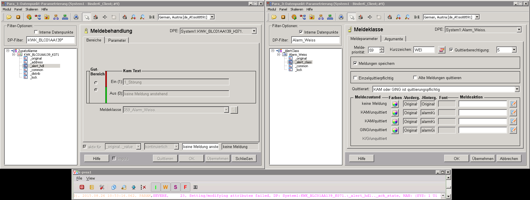

https://www.winccoa.com/fileadmin/image ... _Error.png Can please anybody tell me what is wrong configured? I attached an image to let you see my configuration.

I'd advise you to start your GUI with '-snd 2'. You can then see exactly what alarms are being acknowledged in the LogViewer. It is not easy but I can imagine that the AES panel is trying to acknowledge in the wrong order.
