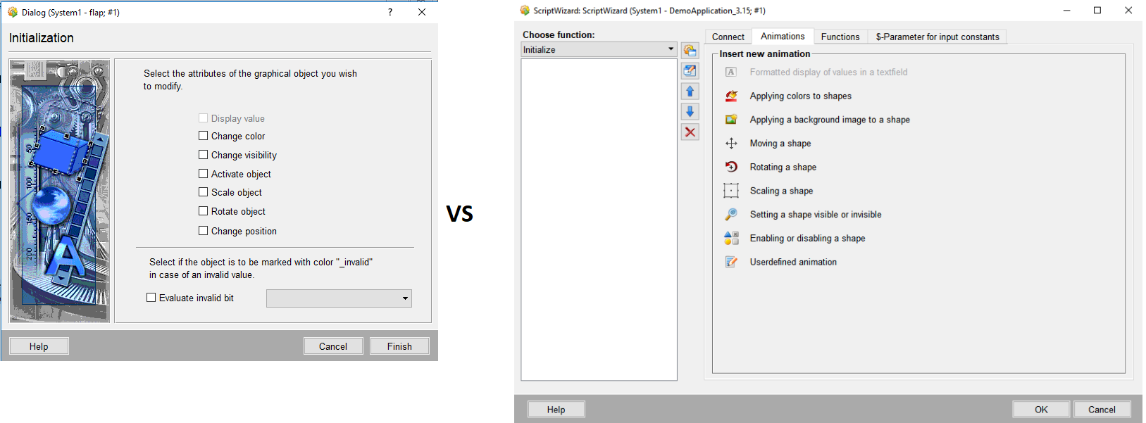

Me and my colleague have both the 3.15 P015 version of WinccOA.
Let's say I invoke a "Open Property Wizard" next to Initialize Event in the Property Editor.
In my case a different Wizard type pops up than in my colleagues case.
I am including the pictures.
Is there any setting to set the type of the wizard that pops up?
thanks
Richard https://www.winccoa.com/fileadmin/image ... rd1vs2.png

In the system management you can find in settings -> central settings the option to switch between the Script Wizard and the Simple Configuration Option. Please check which settings you find there for your project.
Br. Joergen Mad

Thanks Joergen for the quick reply. Your hint made the trick.
Richard
