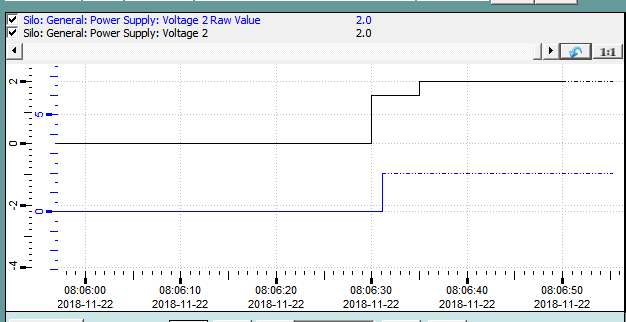

I was surprised to see that the dp_function sets the time stamp of the averaged value to the beginning of the 5 second period being averaged, even with the delay parameter set to 0, so that it effectively represents the average over the next 5 seconds rather than the last 5 seconds.
That gives the impression that the average function is looking into the future, which doesn't really make sense to me.
I hope that loading an attachment works, then this can be seen in the attached trend.

The statistical function works correctly. Independent of the delay the timestamp which is set is always the begin of the calculation interval.
With the delay you can only define that the calculation shall be delayed, e.g. to ensure that all value for the calculation period are already available in the system.
