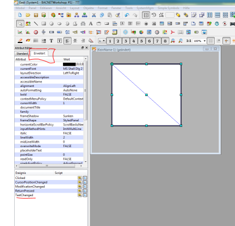

Still looking for ways to count the characters typed in a textedit multiline box, a single textline object has a "text changed" event which is super handy for this, but the multiline object doesn't offer this event for some reason (even though Help says it does). Any ideas are much appreciated, I've tried running a while(true) script in the KeyboardInFocus event, but this slows things waaaay down.

Hi Tom,
There is a second tab in the Properties of the multitext object. There you can find the text changed event!

Post by tpjctrl » Wed Oct 10, 2018 8:01 am
Hi Emanuel,
I've had a long look at the Expanded tab, but only the top section, where all the parameters are, never noticed the bottom section for events changes!
Huge thanks!
