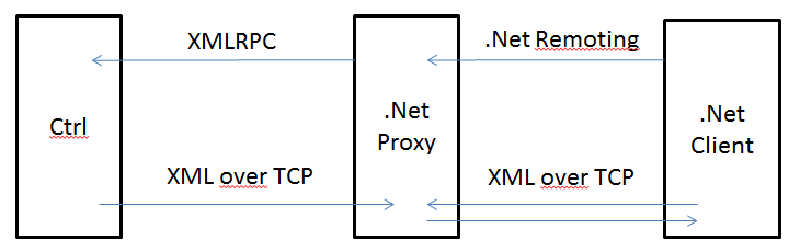

I now implemented a .Net Proxy for a real dpConnect...
Communication from .Net client to the proxy is done with:
* .net remoting for "commands" (dpConnect, dpQueryConnect)
* tcp (xml over tcp) for sending data / events (control to proxy to n client)
The proxy also acts as a distributor - if clients have the same dp(Query)Connects, the connects in the control are done once, and the proxy will forward it to the clients.
take care,
Andy
